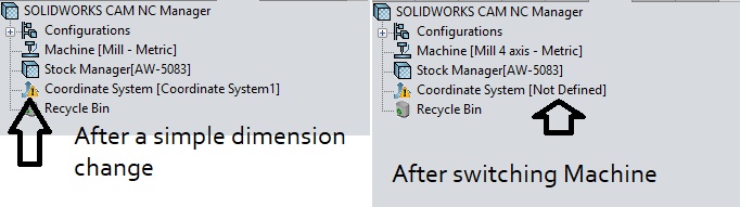

Hi,
Was checking this new coordinate system new feature (comparing to CWorks 2017) but it seems that every time the 3D model gets a change, even on entities that do not affect the SolidWorks Coordinate system used in SW CAM, it get a warning. User must re-edit the feature and hit ok. Time consuming?
On the other hand, if a user switches Machine, the CS entity is lost and requires re-selection. this should be revised, since choosing the CAM reference is of most importance and it should "stick like glue"  and not loose reference so easily.
