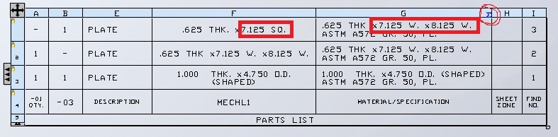

We've recently upgraded to SW2011 and noticed that the BOM's in our drawing package we are preparing for the client have a MAJOR issue:
In a BOM where we have multiple configurations AND equations showing configuration specific properties... they are ignored.
The last configuration is simply shown.
Please see Find No. 3 in the attached jpeg.
I have added the "MechL1" column which shows the correct size of the plates.
In the "Material/Specification " column, we have a formula to display the size and the material spec.: notice this is the info from Find No. 2 (the last config to be opened).
