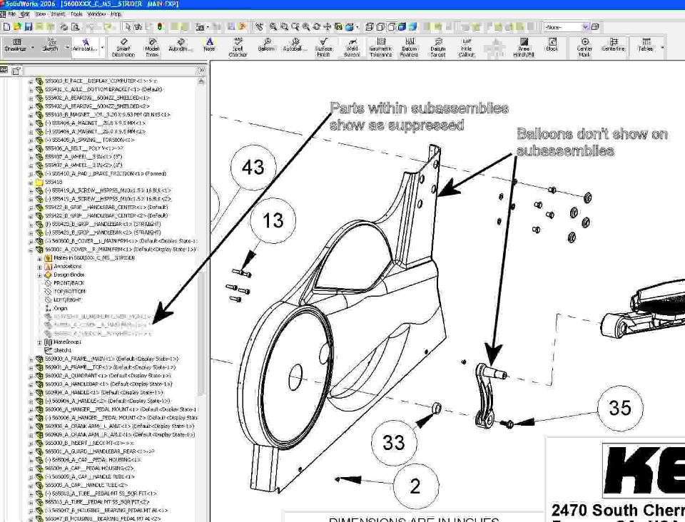

Subassemblies within top level drawing are not showing theballoon. The assemblies show up in the Excel based BOM with thecorrect item numbers. The balloons will appear if I bring inanother drawing view from another configuration, and balloon thesame items. Although, they disappear after I save, close, andreopen.
I have noticed that the parts show as suppressed in the featuremanager design tree, even though they open correctly and are notsaved as suppressed parts. The only thing that I have donedifferently is create this exploded view as a derived configurationof the default assembly.
Please see attachment for a better understanding.
