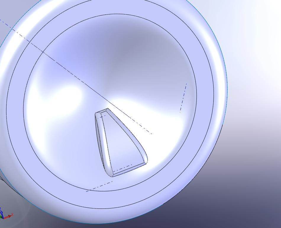

Hi all, I have been modelling a blow moulded bottle part usingsurface tools.
To create various details on the model I have been using the indentfeature. When the feature is done I then go to circular patternwith the selective bodies feature (As the bodies is the onlyselection that the feature manager will allow me to select.)
The circular pattern feature will then work succesfully butlayering multiple surface layers over each other whilst patterningthe indent feature or not work. This is a problem when I then go totrim the patterned surface or edit it as there are multiple layers.
Note: surfaces have not been knitted together so I am trying toselect just the indent body feature to pattern.
I just thought I would post to see if anyone has come across thisproblem before?
