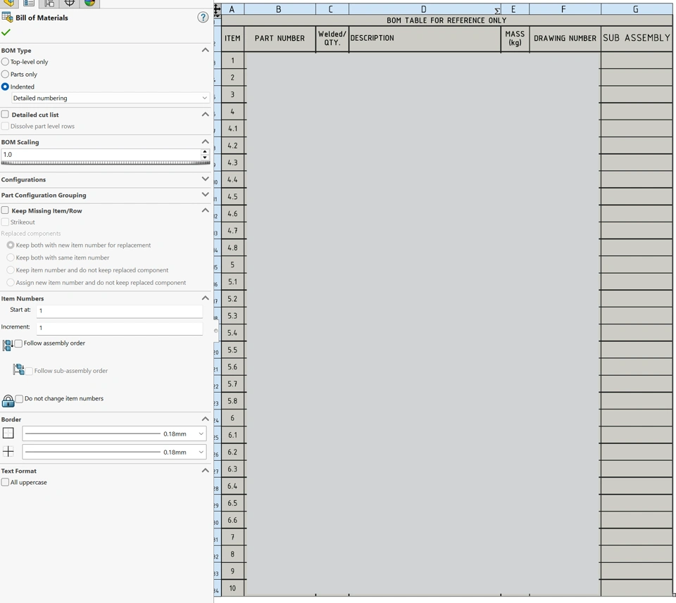

Can the Bill of Materials, BOM, have a column with the name of each parts sub-assembly?
I have a general assembly with thousands of components and multiple levels of assemblies.
I want to create a master BOM with a column that names each component's direct subassembly. The 'indentation' feature is helpful but not everything I need. Effectively, on the image below, I want the Part number for Item 4 to appear in the 'subassembly column' for 4.1 through to 4.8. And the same again for Item 5, that Part number appearing in 5.1 through to 5.8 etc. This gets more complicated when sub-assemblies goes to multiple levels e.g. 26.3.5.2.6.
I don't want to add a custom property for each part because parts are common across different sub-assemblies for different builds. Also I'm not using a PDM (I know, I know, its in the pipeline, the company I've started working at hasn't got there yet)
Thanks in advance
