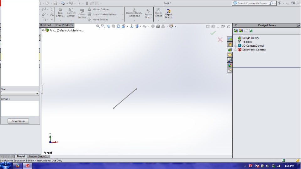

I am having a problem when using the structural members function in solidworks. For some reason, its not showing up anything (iso or ansi). Anyone have any suggestions on what I should do to get them to show up again. I am ultimately trying to get my own weldment profiles to show up, but right now I cant get anything to appear. The drop down box under type is blank.
Additional Info: I have recently upgraded from 2011 to 2014 (student editions for school). When I had 2011 I had gone in an given "write permission" for me to create my own weldment profiles and save them. I dont know if this affected anything when I downloaded 2014.
Here is a picture of what I'm talking about. The drop down box is just empty. Thanks!!
