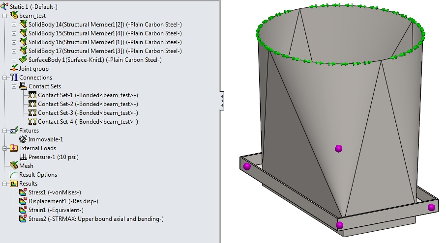

This issue comes up repeatedly in my analyses so I have built a small model to isolate the problem and try to find solutions.

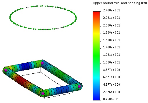

This is a model of a storage bin outlet with a normal pressure applied on the shell. The outlet is stiffened with beam elements. I am using a mixed mesh with shell/beam elements with manually defined contacts. I am doing a simple static analysis. The stresses in the beams are not symmetrical while the problem is perfectly symmetrical. The stiffness of the beams seem correct because the deformed shape is symmetrical.

Good point: they are not symmetrical unlike what I said in my first post.
Here a stress plot with rendered beam profiles:
comment imagecomment imagecomment imagecomment image

Jared, I think you misread, displacements are NOT the same.
I followed your suggestion: suppress the shells, fix the 4 joints, and apply a force to both beams.
stresses now look pretty close:
however, the deformed shape is still not symmetrical:
I think the forces are applied to the neutral axes of the beams instead of the shear centers so it is normal for this section (an angle) to rotate somewhat, but still it should be symmetrical.

GB
GB 2015-03-12
Rotating the L does not help, results still do not make sense.
I then tried having the 4 members in 4 different groups instead of 1 in my weldment feature. This solves the issue:
The problem comes up when members are in the same group even if the group does not form a loop:
However, when the group type is 'inline' (without change in direction), it works:
