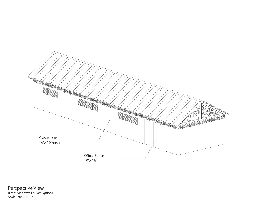

I use SW2009 for developing medical devices and aircraft hardware in my day job.  I wondering effective means for me to help with some building drawings.  I've never done much in the way of building drawings, but  how hard could it be?  This one is a transitional school to replace schools destroyed in the Haiti earthquake.  The group that I'm volunteering with has built similar schools in Indonesia, and has existing drawings in Rhino that need modification.  See the attached PDF.

- What are good approaches to doing this type of drawing in SW?  I imagine that goals are to be able to readily modify the design, and tally the amount of construction materials consumed.
- Any advice on importing from Rhino?  I am supposing that it will import as a dump STEP file or similar, and I'll have to recreate the design.
