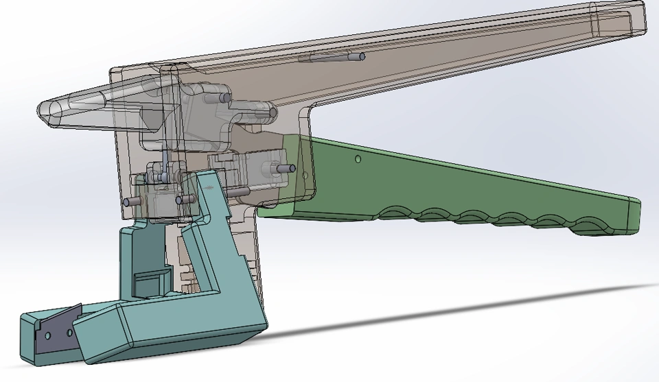

For a project, I am building an existing product in SolidWorks and chose to model this Egg Cracker:

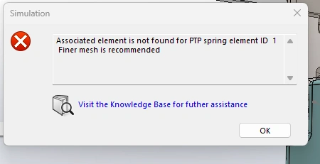

No matter how I change the mates in the assembly or the meshes/local interactions/pin connectors in the static study, I get the same error.

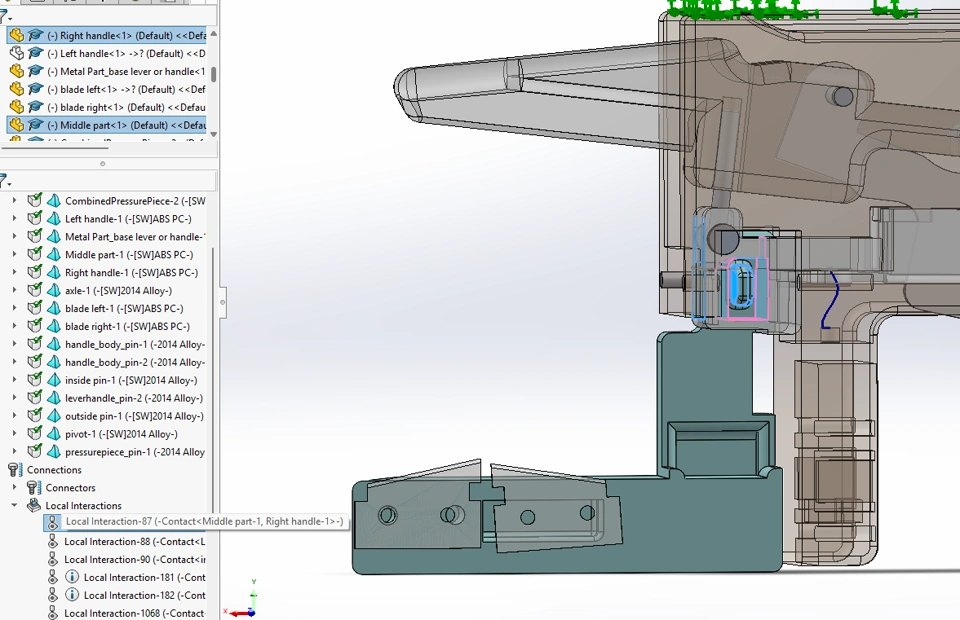

The meshes are at the 'finest' for all parts and in the assembly, all the mates seem happy except the middle piece and the left/right egg holders (turquoise) are not mated at all in the assembly. In the Static study I just used local interactions for the study to know that they are in contact when the lever (green) is moved down or up.

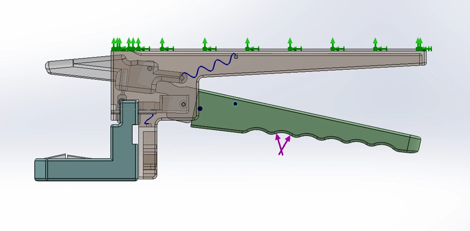

Here is the image of the fixed top face, force placement (5lbf), and the 2 spring connectors in blue:
Does anyone have any advice on what I can try next to get this static study able to run?
