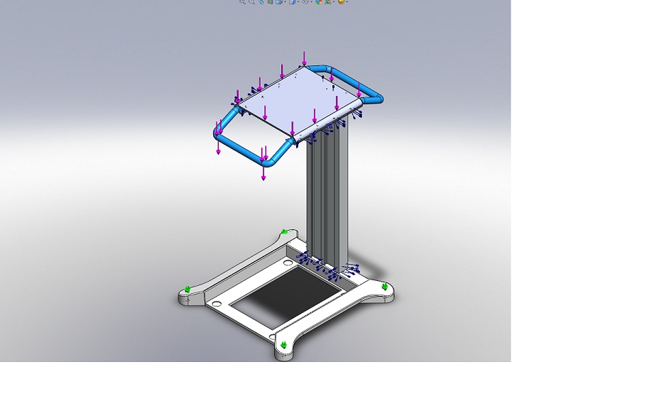

Im running a Static anaylsis test on a Portable Cart we are designing to hold and move Hospital compressor/ventilator systems.
I am trying to simulate the stress/displacement/strain and FOS of the cart due to a 200 lb load "basically a nurse pushing down on the handle as hard as she can" along with the total weight of the ventilator it will be holding.
However when I run the simulator, it gets 34% done and says Error:"Equilibrium is Not Achieved" "Results will be saved upto the current iteration."
Below is a picture of the Cart and the constraints ive added to it.
Material: I cant specify exact material, but its a combination of Steel and aluminum
External Loads: I have a 200 lb load normal to the bottom plane, with a 100lb load uniformially distributed over the head of the cart.
Connections: I have Threaded Counterbore screws going up through the base into the spine (bottom) and also connecting the handle to the head (cant see those from this view.) I set all of the coincident interference as no penetration, and I did a contact set between the welded parts.
Fixtures: (THIS IS WHERE I THINK I AM HAVING ISSUES) I fixed the bottom left corner of the base completely by selecting the Cylindrical face of the "shaft" where the casters (not shown) will attach. Next, I selected the other 3 cylindrical shafts and added a vertical constraint.
*IF anybody can help me out, that would be a huge help...my boss and I have tried several different ways of fixing the bottom to get the results we are looking for but arent having much luck.
