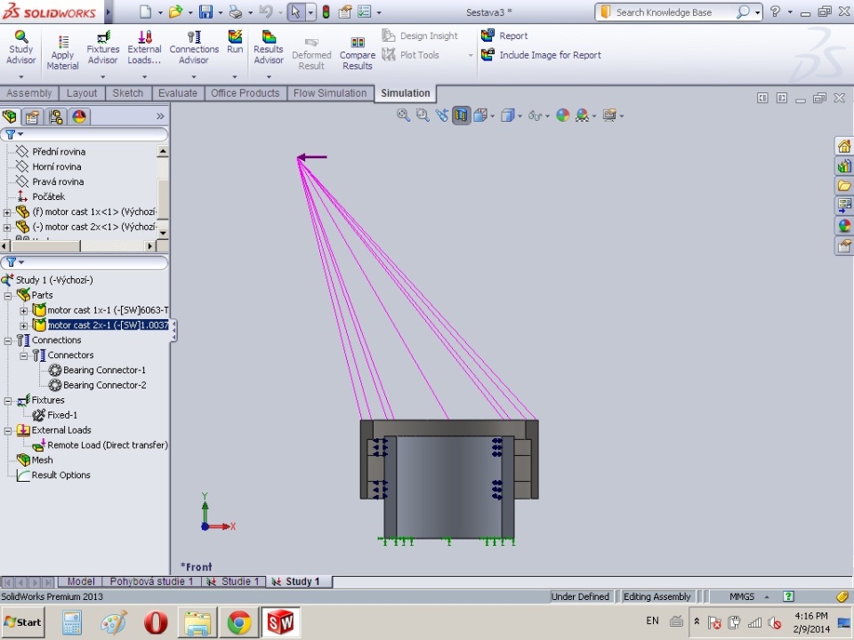

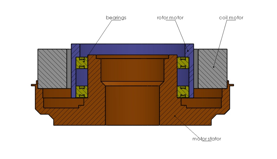

I would like to verify static analysis and do not know whether the procedure well.
Is the electric motor, see Fig.1
I simplified the analysis model, see Fig.2
I replaced bearings - bearing connection.  I placed a Fixtures - Fixed on the stator.  I placed the Remote load (Power) of the rotor.
The analysis must also define - Component Contact and Fixed on Cylindrical Faces?
Thank you for any advice.
