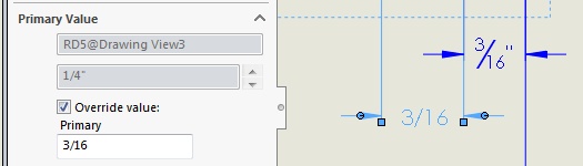

Hello all,
Our standards have us diagonally stack dimensions at 80% resize.
But, when you override a fraction's numbers, it goes side by side.
The highlighted dimension is overridden to say 3/16, but I want it to look like the 3/16" right beside it (doesn't look right being the ONLY one that's not stacked).
Is there a way to get an overridden dimension to stack per the standards?
