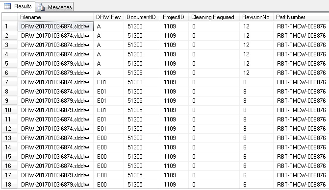

I created a View that makes a table showing a document's file name, revision variable, document ID, project ID, cleaning variable, revision number, and part number variable.  However, there seems to be a row for each value of these variables.

Here are my results:
What I want to have is something that shows one line for each RevisionNo and it should be tied to the corresponding values for the file that is at that revision. In the image above, the correct line for RevionNo 12 is line 5. Looking into SQL commands, I think I need to use the UNION command, but I can't quite figure out how to format it.
