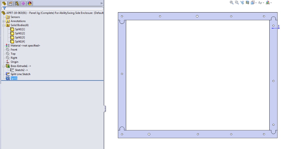

Been using the Split Feature to turn a single part (basically a frame) into 4 separate parts (left vertical right vertical, top & bottom)
Everything has worked fine & I’ve created the new parts & associated drawings
One thing I’ve noticed is that the original source file shows the 4 separate bodies in the solid bodies folder as shown (with no part names , just SPLIT[1] etc ):

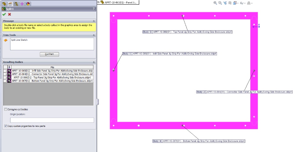

I have to edit the split feature again for me to know what the part names of the newly created parts are:
Is there a way for me to get these part numbers to display in the feature tree against their bodies?
I’m thinking in the future when this part is opened by myself or a colleague, it would be rather awkward for me to find out the related newly created parts by either having to edit the feature again (if I remember to do so!) or blindly searching my files for the parts &  drawings
