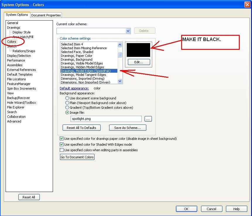

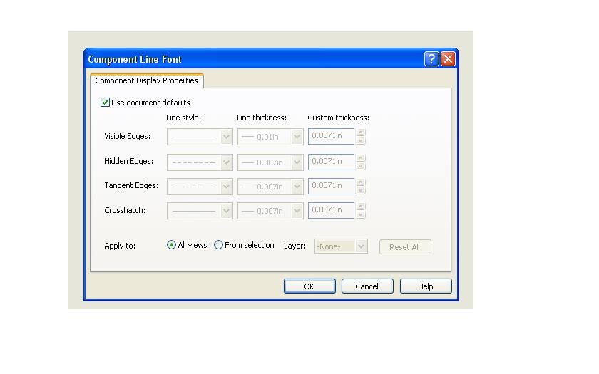

Is there a setting somewhere to prevent this? When I print a drawing that contains a view from a Speekpak assembly, the lines are blurry/thick and gray.
