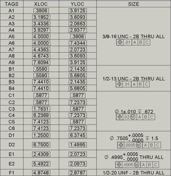

I've been using hole tables to simplify drawings where possible. Generally, when I use a hole table, I'll specify all position tolerances as basic and add a geometric location tolerance for each group. However, I don't know how I can specify the position tolerance of holes in a hole table as basic by default. I can obviously change the tolerance after I create the table, but how can I do it automatically?
Also, it doesn't seem like I can attach a geometric tolerance to a dimension in a hole table so they all end up "floating" on the table instead of being attached to the hole size dimension. If I add or remove a hole, the table changes size but the geometric tolerances don't move so I have to move everything back.
