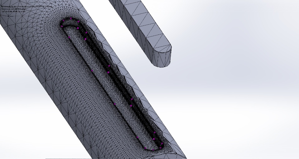

I need to evaluate the stress concentration in a shaft´s keyseat.
The solver runs with a standard mesh:
However I need accuracy, so I refined the mesh on the keyseat but a problem came up.
"Number of target sub-surfaces per element > 1000 "
I defined the general contact as non penetrating and the local contacts between the faces of the key and keyset and cube as non penetrating too.
Has anyone dealed with this? I searched in the forum but I´ve found nothing.
SolidworksSimulation

BM 2013-11-28 Best Answer
make the mesh finer on the key.

To add to bills comment, start simpler. Does your problem work bonded? Don't add no pen until it does. Then work with draft quality coarse mesh. Until it works, don't refine the mesh.

the solver ran bonded.
like bill said, making the mesh finer, the solver ran.

Hi I came upon the same problem
My study is a nonlinear contact simulation.
I used mesh control in my contact area. (0.03 element size) (1.2 ratio)
Component contacts is set to no penetration friction set at (0.1).
I do not have the opportunity to make my model bonded.
Because that will not be equivalent to the mechanical application, I try to simulate.
Is there any way to reduce number of target subsurface per element >1000 other then make the mesh control coarser and eliminate fail message.

do you have access to the solidworks kb? there are several articles on this error that might be pertinent
as per the OP's solution, using bonded or allow penetration global and then local contact sets is one of the recommendations

Hej Jared, thanks for your  fast reply.  I don't know if I can get access to solidworks kb, i am an student i Denmark but i will check my software Provider.
I have tried to make local contact set and global penetration. but I still get the fail message, when i go below 0.04 mesh.
Is there any free explanation on why the problem occurs?   Because when i zoom down on the mesh no element is facing more then a few contact elements ? So I simply don't understand the fail message.

simon, the recommendation is global bonded and yes there is a deeper explanation of what is going on and some more troubleshooting methods to try.
do you really need that level of mesh resolution?

Hi Jared. yes and no, i don't need it to achieve convergence I reach that at 0.075, but my professor told me that when I thought the mesh was really fine, i should make it even more detail. So i am actually just trying to find the lower limit on the mesh parameters on my geometry.

The solutions was:
1) Make global allow penetration
2) Define the contacting faces manually.
3) Ensure that contacting faces have the same mesh size.

I am also facing same problem,  by changing mesh sizes of all mating parts i got the solution on this problem.
