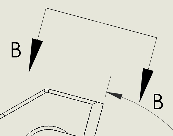

SolidWorks16 is not aligning Center Mark correctly
I have a part that I am trying to detail and SolidWorks is not aligning the Center Mark of a hole properly.  I have tried several things but it still offsets the center mark significantly (practically on the edge of the hole).  The hole is on a surface that is 15° from the top plane.  I have a section view and have set the cut line parallel to this angled surface.
Any input?
