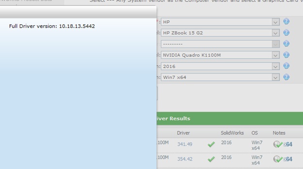

I am having a unique problem I have 3-4 Computers that are all having the same issue.
Where SOLIDWORKS RX is only recognizing the onboard graphics card and not seeing/using the secondary K1100M Card.

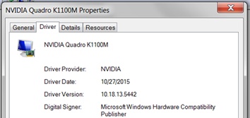

I have manually updated the drivers from the SOLIDWORKS Website. I have played around with disabling the card in the device manger but after a restart the computer, the card is re-enabled. Though I would prefer not to do this. and the change doesn't seam to stay
Has anyone else come across this issue? My Computer Specs are below.
- HP G2 15 Labtop
- Windows 7
- SOLIDWORKS 2016 SP 3
- Nvidia K1100M (Driver installed: 10.18.13.5442)
