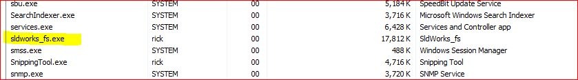

Initially "sldworks_fs.exe" is loaded and running on computer during initial login (it's in my start file).
(although I can't see that is does anything since if I remove it or leave it, I still have the same load time and errors) - but I guess this is a whole other subject.
When "Solidworks.exe" is not loaded yet - only sldworks_fs.exe is loader from startup file.

When I Double click again on any SW file within a short time (while the first instance of SolidWorks is still showing that it is loading) an additional instance of SolidWorks shows up in the Task manager
as well as another error message. This will happen repeatedly, adding instances each time.
It seems, If I wait long enough that SolidWorks would have fully loaded - maybe a minute or more, then double click a file again it will open the SW application on the screen along with the drawing (I just selected) without error.
But, it will still show the 2 (or more) instances of SW running along with the sldworks_fs program (and never loaded the drawings, parts or assemblies).

When I have only one instance of SW open and then close the file and then the application I will only have the "sldworks_fs.exe" remaining in the task manager as I believe I should (or should I?)
