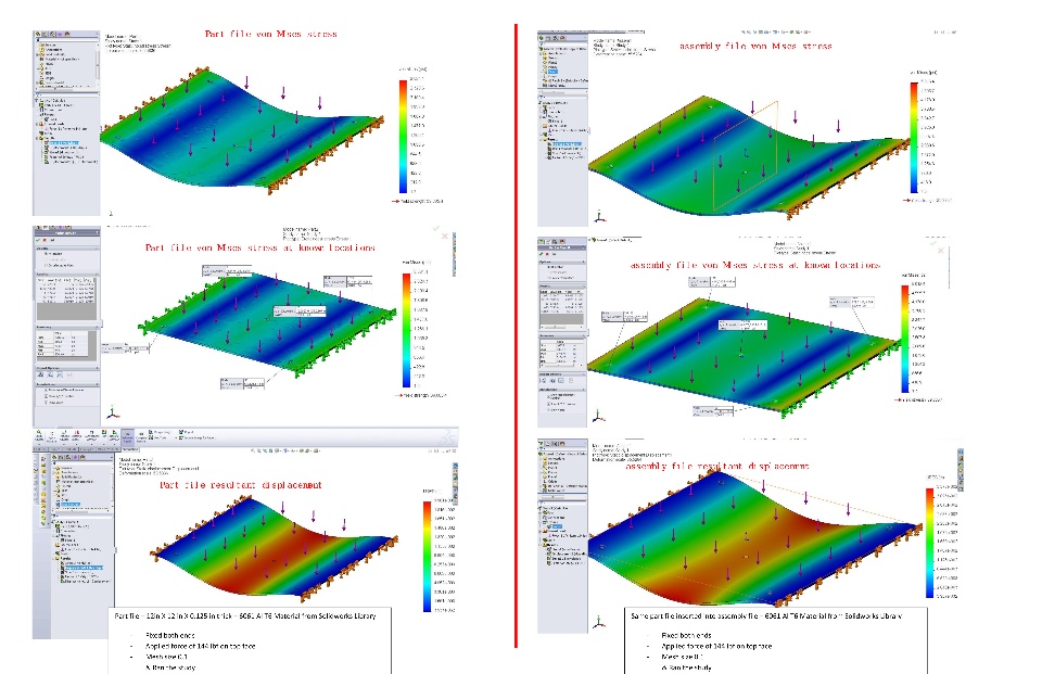

I was trying to run study for some problem and just wanted to run a simple study to compare results between part file simulation and assembly file.
For this -  I created a simple square part 12 in X 12 in X 0.125 in thick.
               Applied Aluminum 6061-T6 from soldiworks library
               created static study with fixed both left & right faces & applied 144 lbf force on top face as shown in attached results file & ran the study.
             - Inserted same file into assembly file and re-created same simulation model and ran the study to compare results.
I found that assembly simulation model seeing more stresses and displacements. Could somebody help me understanding why results were so different?
