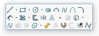

The  "shortcut bar" ('s' on the keyboard) is a great way to access in-context tools, saving you mouse travel by giving you the tools at your cursor:
You can customise what is showing by either RMB on the toolbar when it appears, or within Tools/Customize.
They are even context sensitive, meaning you only get the tools you need at that time. Mine are shown below...
My SKETCH shortcut bar:
My FEATURE shortcut bar:
My DRAWING shortcut bar:
