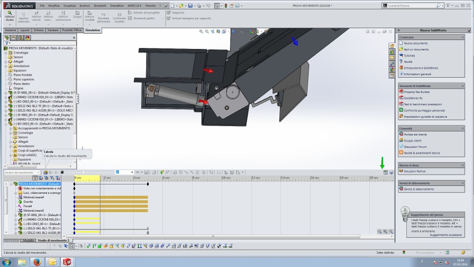

I have an assembly based on two main parts, one fixed the other one
movable. The movement is operated by two oleodinamic linear
actuators, they work in parallel and have same dimensions and connections.
Purpose of the motion study is to have motor forces.
I used a linear motor apllied on each rod of the actuators,
I run the calculation, when I look to the graphs,
I obtain one actuator with motor force near zero for all
the movment, and the other one that has a value
double than expected.
I can get why I have the result, but there is a system
to have the result with the force splitted correctly?
Thanks for your reply,
Luca
