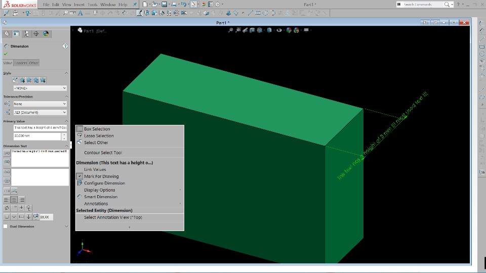

Attached is a picture of the problems that do still exist.
There are still 3 different fonttypes in the UI of which there are 2
that do not change when Windows settings change.
These 2 fonts cause problems in high resolution screens.
I adjusted all Windows size fonts to be 11 points.
Menu text and RMB and tree text has a height 5 mm on my display.
Now look in the pics of the property manager and find these messages:
This text has a height of 4 mm
This text has a height of 3 mm !!! most used text !!!
You can only adjust the text that is 5 mm height, the fonts of
3 and 4 mm are hard coded. These are too small to use on 4K screens
at smaller size. As a result I only can use 2560x1400 at 27".
