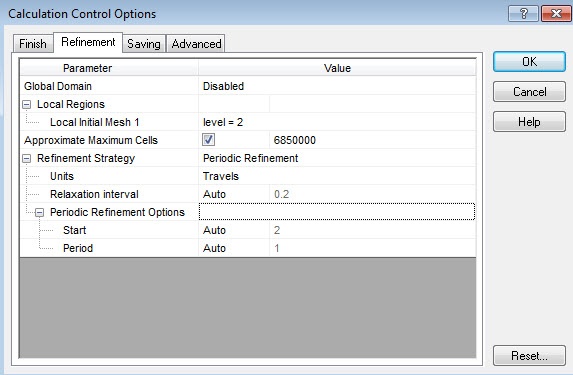

Adaptive Mesh on a local initial mesh
I tried this one and it's cool: just define a local initial mesh, and then in the calculation control options you'll have the option of using adaptive refinement on that local mesh. It will be very useful when you'll want to concentrate refinement on a very local region (like the smallest gap of a valve).

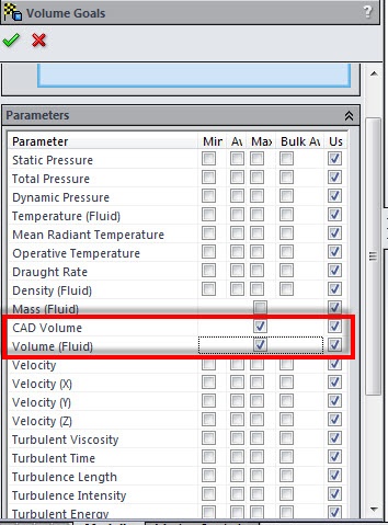

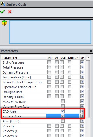

    1 - CAD Volume, CAD Surface Area, Fluid Volume, Fluid Surface area defined in surface and volume goals

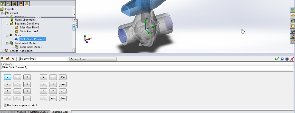

     2 - New Interface for the equation goal (at the bottom of the graphic area)

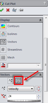

  3 - Dynamic Vectors. The dynamic visualization of vectors allows you to update the distribution of a vector parameter in real time as you manipulate the model, even as you zoom-in on local areas.
Couldn't really try this on my virtual machine because it doesn't see my OpenGL Card. I found the button, so I guess the feature works:
