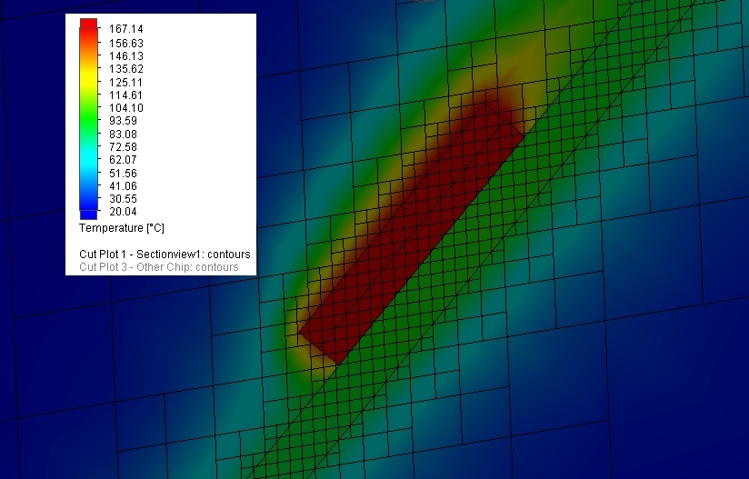

I have noticed that the temperature profile between a chip and a pcb changes as a function of orientation of the pcb.  Unfortunately, we do not have the luxury of having all of our products pcbs in a convenient orientation.  If one pcb is orthogonal chances are another one in the same product will not be.  The issue I see is that for a 'flat' board the heat flow from a chip into the pcb (pcb is defined having different thermal conductivity across board vs through board) is smooth for the flat case.  However for an angled board, the transition is abrupt. I expect the transition to be smooth and then drop off rapidly thru the board but slowly along the pcb.

Split chip above has heat applied to mid-plane surface.  (I expect the thermal gradient to be smooth from chip to pcb)
