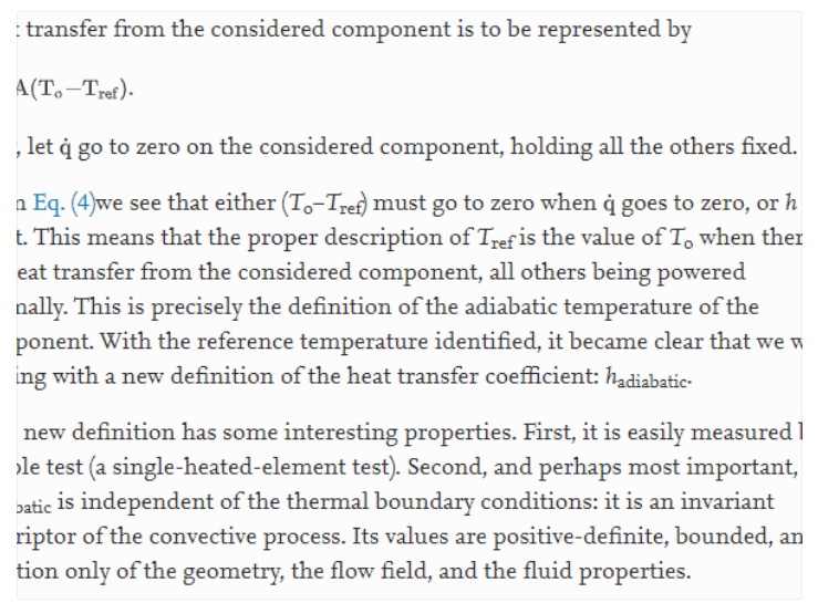

When selecting criteria I'm given two options -- adiabatic HTC & (non-adiabatic) HTC. I've run a few differnt simulations with differing boundary conditions & all of my hand calculation (excel-driven) values match for adiabatic HTC. The (non-adiabatic) HTC values are always lower. The only literature I've been able to dig up online is below (sorry for the bad crop, source was like this):
So my question is: what is the difference between the two?
