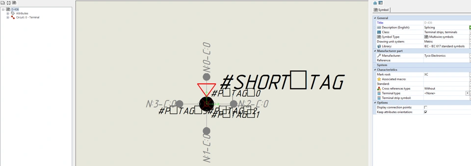

Could you please help me — how do you handle wire splicing, for example using D-436 or something similar in solidworks electrical?
Here’s the issue I’m facing: I created a component.

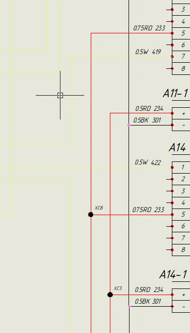

I connected it in the schematic. For example, let’s take circuit '233'. I assigned an equipotential, and no conflicts were detected.

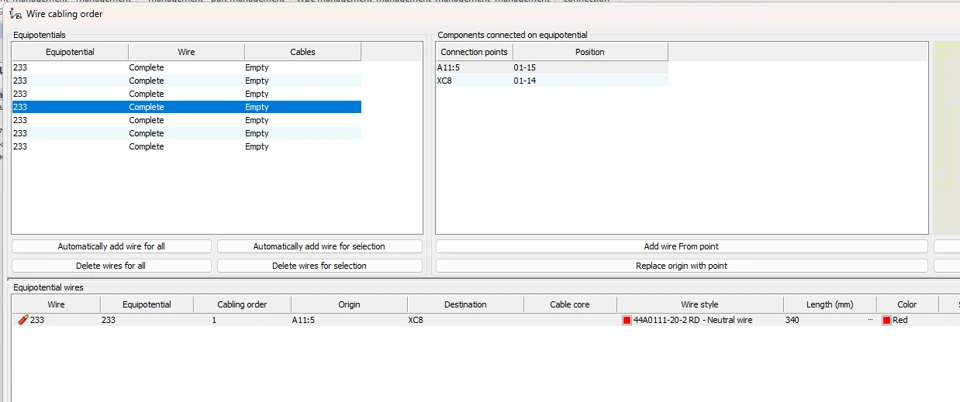

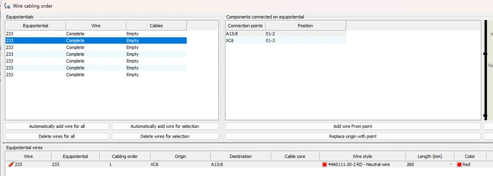

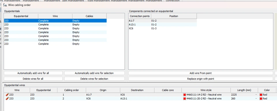

And here’s where it gets interesting: in the Cabling Order, it splits one circuit with a single equipotential into multiple circuits.
And now, if I need to reassign the wire routing order — I’m very limited. For example, A11:5 is supposed to go to XC6, but right now it's going to XC8, and I can't choose anything else, because the software splits it into several different circuits. How can I fix this? What do I need to do to make the software understand and provide correct data? Or are there any other options for how to create wire splices?
