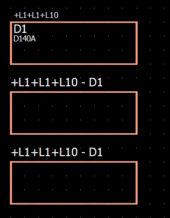

Hi,
I have a question on copy-pasting custom Location Labels. I have created a custom Location Label with certain attributes positioned in the way I want. I selected the custom Location Label to be the one for the project under the Project Configuration menus (Symbol tab). When in a mixed scheme sheet, I can use the custom label through the Location Outline command in the top toolbar, and draw an outline. The outline populates the custom attributes, no problem. But when I try to copy-paste the location outline I just drew, the new instance always reverts back to the program's default location label.
You can see in the image below, the top instance of the label is the custom one that I placed via the top menu bar Location Outline command. I sized the location outline box myself, manually. It has the proper attributes.
The next two below it are attempted copy-pastes of the first, both revert back to the default label. Notice there's no attribute text inside the outline.
Is there any way to copy-paste location outline and retain the custom label attributes instead of the default?
