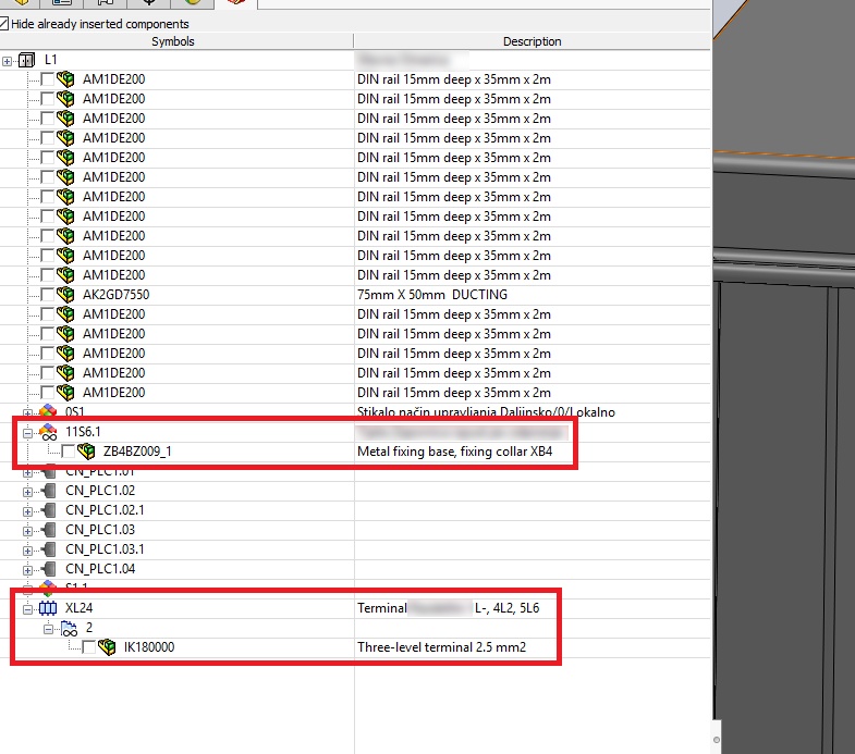

Example
So here is one live example: right now, I have total of 333 associations (and much more parts) in all of my locations. I am going to delete inserted “normal” part (without electrical components/associations) in location L2+L5, so there shouldn’t be any modifications to table tew_entitiy3d. Deleted part:
So, after deletion of this part there are only 331 associations left, so somehow the deletion of plain old part (in L2+L5) results in deletion of 2 more associations somewhere (in this case in L1+L1) in my project. After Excel SQL pooling of database, I can identify which parts lost association:
e3d_id
18107
8900
9154
6877
8900
7415
ZB4BZ009_1
837
11S6.1
+L1+L1
  1. 9154.sldasm
18270
5200
9154
13377
5200
5060
IK180000
837
2
+L1+L1
  1. 9154.sldasm
ID is selected randomly, both are from same location L1+L1 which is the location with most parts (main electrical closet).
Image proof:
Maybe if we had a log of SQL statements executed to database we can better understand what is happening, well here it is: https://forum.solidworks.com/servlet/JiveServlet/download/773736-180821/SQL_statements.txt.zip (attached .txt)
This are statements executed just after deletion of the part and we can see that it starts with:
(@1 smallint) DELETE [tew_entity3d] WHERE [e3d_id]=@1
So somehow this statement is run with some parameters just at deletion of the part and it’s clear that it modifies table tew_entity3d. The parts IDs must have been 18107 and 18270, as they are missing from the table.

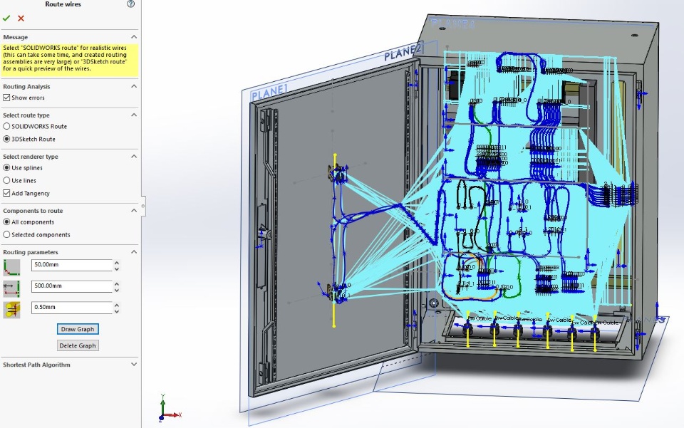

Tried SW2018 SP0 and SP0.1, as I explained in the post below (on Oct 14, 2017 3:05 PM) it appears they have resolved the bug in new version but introduced another one:
broken Route wires tool - wires don't rout along EW_PATHS and the problem is more evident with command "Draw Graph" which makes total nonsense:
SW2018
vs SW2017:
I thought, maybe it is like this because the project is SWE2017 originally, so I made simple SWE2018 project and this is the result:
(SW2018 SP0.1)
And the routing was just wrong - all wires through center and none on PATH.
So I am done with SW2018 till SPx.x it should be an easy fix I mean, they already got it right. Unfortunately new SP wont be due for some time (2 months?).
I am looking forward to SW2017 SP5 but expect nothing .
Update (10.1.2018)
The bug for routing persist even in 2018 SP1 and it appears it was introduced with 2017 SP5 (image result of Draw Graph command in Example assembly Elevator).
Its just a shame Solidworks couldn't solve the 2017SP5 and 2018SP1 routing bug (Draw Graph above). Maybe that one needs a topic too.
