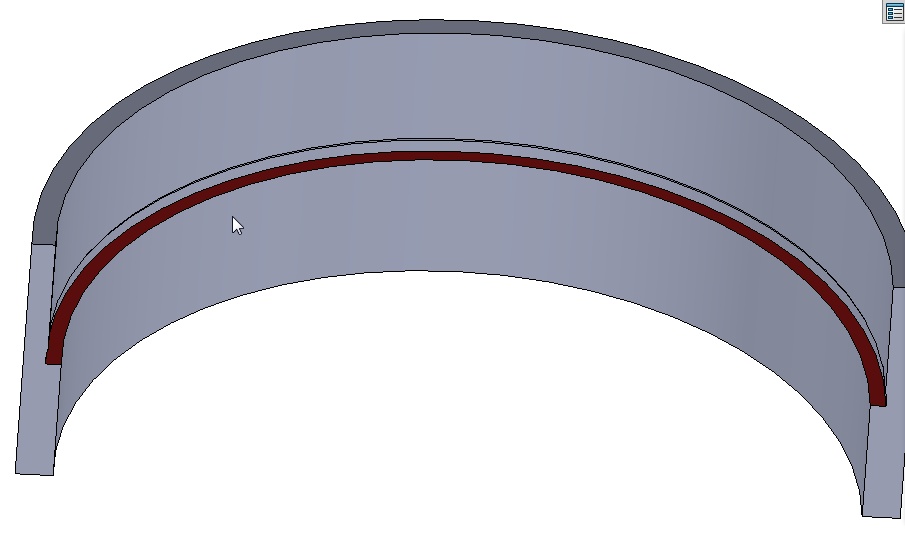

when I run my code I want to select a horizontal face. But the variables I give get changed when used in SolidWorks.
Or so does it seem.
In the pictures you see what point does get selected in the solidworks part as a picture with a red piece that is the face I want to select.

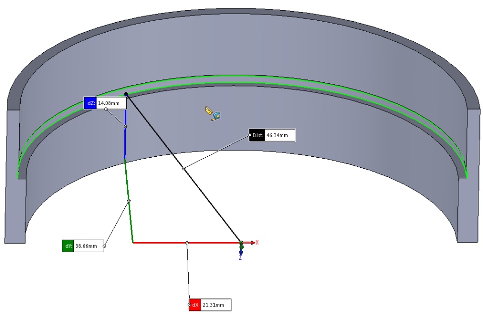

The other picture are the numbers that the program has for the variables.
code:
Alpha = Pi/6
varcutthroughcylindercircle = 85/1000
varcylinderheight = 29/1000
varheighttopcut = 18/1000
dX3 = -(Sin(Alpha) * (varCutThroughCylinderCircle))
dY3 = -(Cos(Alpha) * (varCutThroughCylinderCircle))
dZ3 = -(varCylinderHeight - varHeightTopCut)
swModeldoc.Extension.SelectByID2 "", "FACE", dX3, dY3, dZ3, False, 1, Nothing, 0
