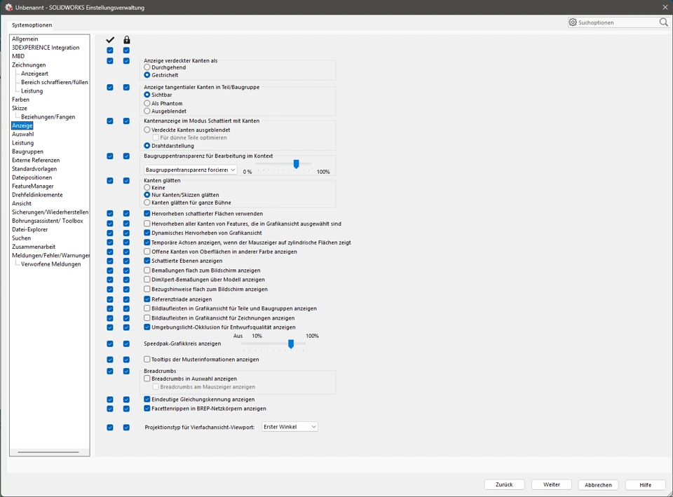

1. Some Settings I specify in the AdminOptionSaveFile (.sldsettings) via the AdminOptionEditor, don't get applied and yes I have checked the lock Icon on the corresponding settings correctly.
Example: Display Temporary Axes Upon Hover Over Cylindrical Faces is set to True and is to be applied on every start up and is also locked. When a user opens SolidWorks for the first time, after starting his PC, it gets disabled, when closing and reopening SW, it all of a sudden gets enabled.
2. There a multiple visual glitches in the AdminOptionsEditor. Example: When reopening the .sldsettings file, a certain setting (Can't remember the name) which has been previously locked, appears unlocked, when hovering over said setting the Icon switches to locked.
3. Settings I had defined in a previous session, get changed back or change to an entirely new setting, when reediting the same .sldsettings file. Example: Force Assembly Transparency, even when locked, changes back to the default setting. In this case the setting does get carried over to the users, but there are other settings that don't get applied.

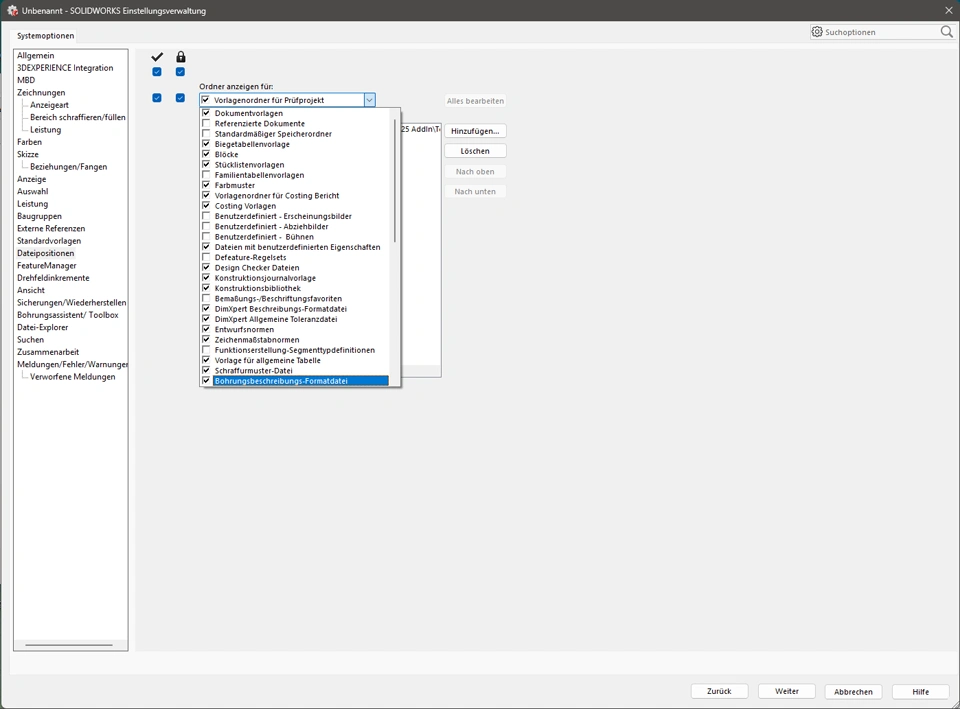

4. The recent file folder is only temporary for users. After logging out it is deleted from the registry. WHY? It's not locked in the External refrences setting. There are other file Positions which have to be locked in the External refrences setting.

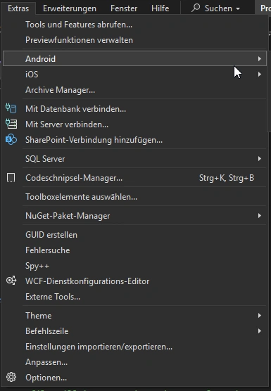

Ps. Not sure if this is common knowledge, but I found out that the SolidWorks Settingsmenu (overall a lot of menus) look very much a like to the Microsoft Visual Studio menus.
