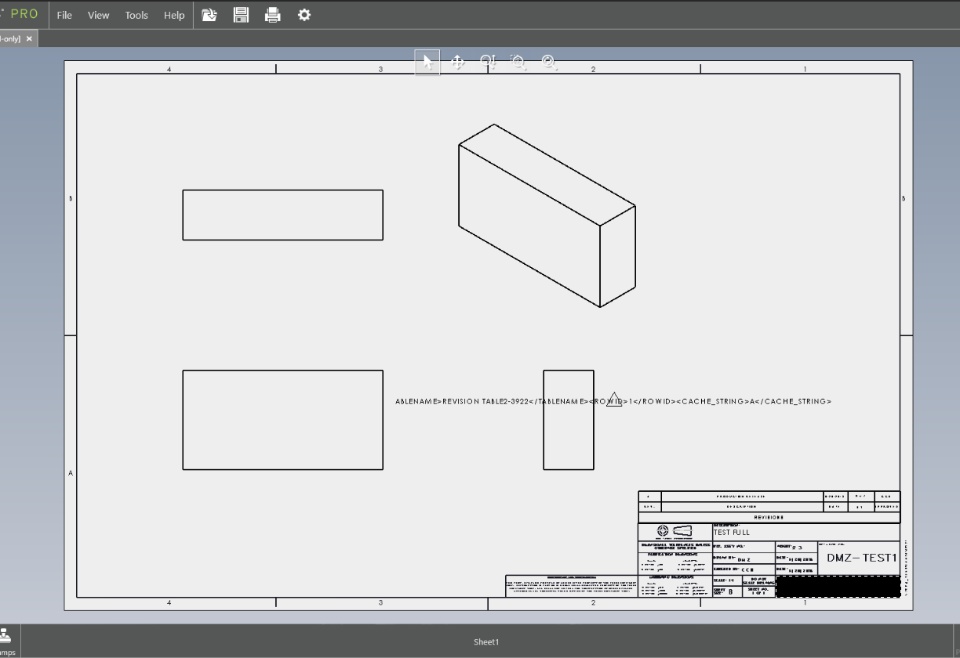

I'm having a strange issue with the SWX PDM previewer and eDrawings.
When my revision is completed, the revision symbols don't display the letter revision.
Instead, they show a string of what appears to be data reference codes.  See below:
The file looks like this momentarily when opened in Solidworks, but resolves to the proper letter revision right away.
Has anyone else come across this problem or have a solution?
