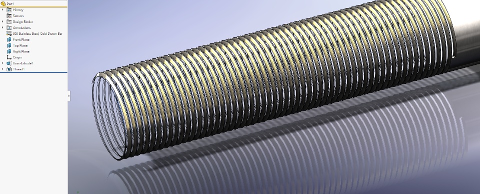

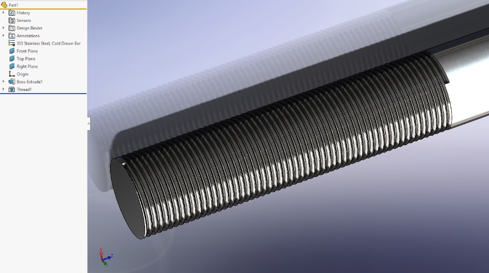

When adding a thread without any offset to the profile, the thread is being created correctly as below:
When adding an offset to shift the profile away from the end of the shaft I am getting the result below with the end face missing & the root of the thread is also missing & I can see through the shaft.
