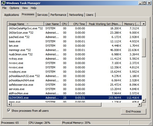

The next day when trying to open a part the same problem occured: the program hangs. It is using 100% cpu (1 of my 4 cores), the memory stays the same.

After looking on the internet, I tried to thick on: "Use software OpenGl". After which I am able to use the program, but much more slowely. I tried the following:
