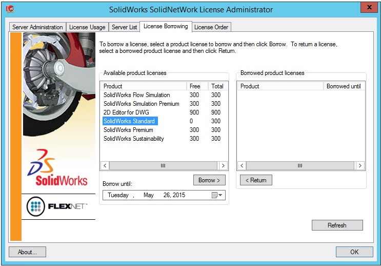

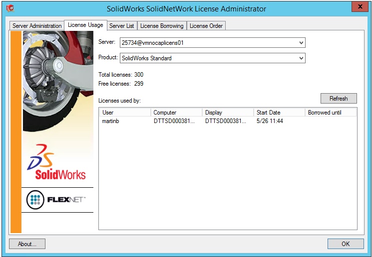

Attached are some screenshots from my license server and a Windows 7 client. Both show the same information, that I have 300 total licenses, but standard is unable to be borrowed.

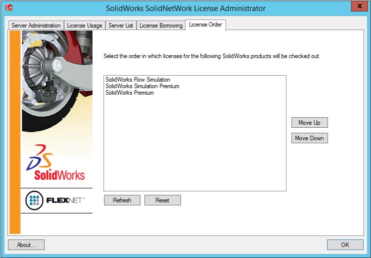

I've seen hints that the licenses might be in the wrong order? I find it strange that I don't see the standard license in the License Order tab.
