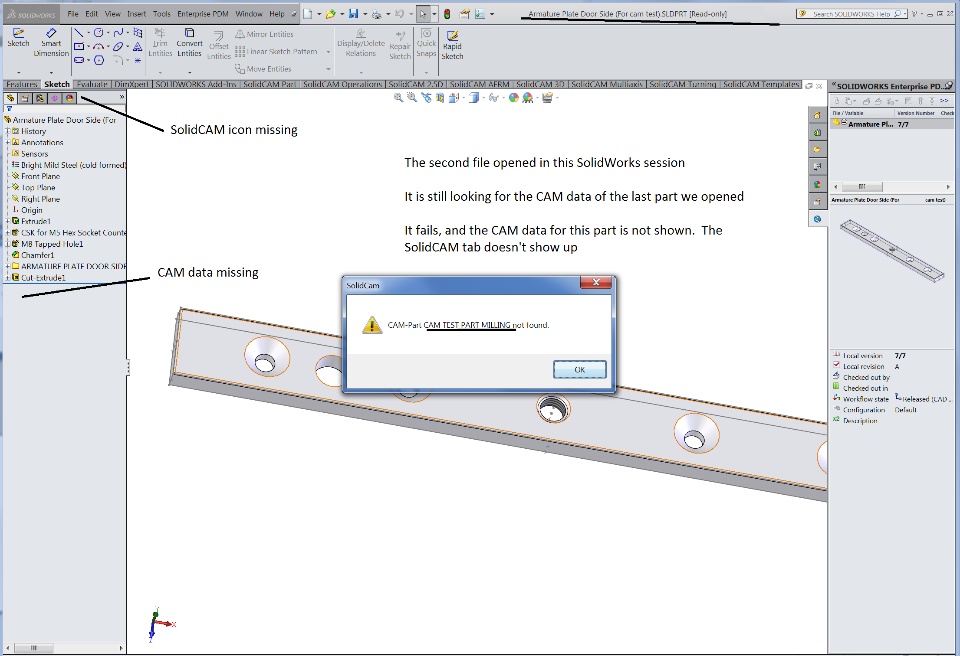

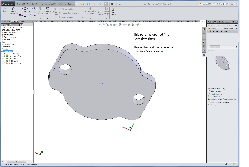

When we open the first file from the EPDM vault with SolidCAM data, it works fine.  We can see all the CAM data.
However, when we open a second file from the EPDM vault with SolidCAM data, it says "CAM MILLING not found" for the FIRST part.
No matter how many parts we try to open from the vault, SolidCAM is still hung up on trying to find the CAM data from the very first part.

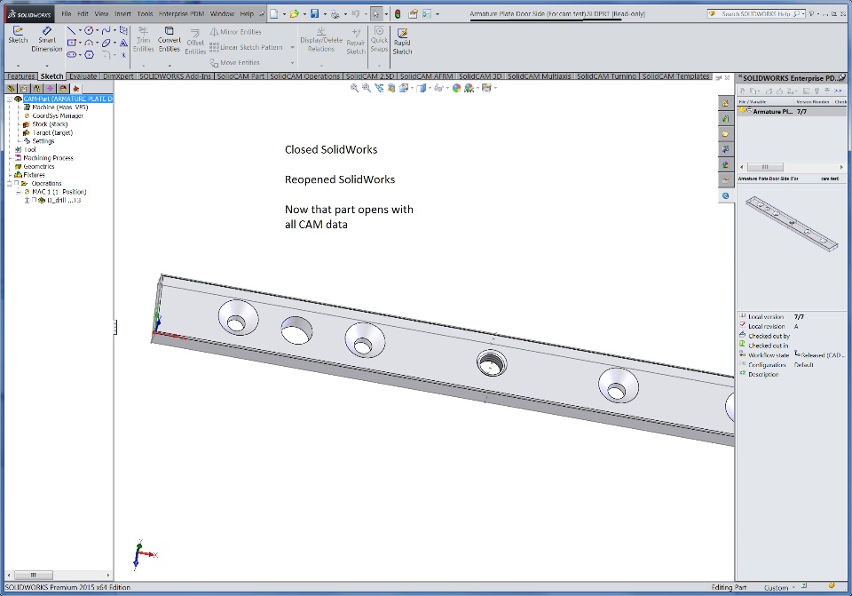

If we close SolidWorks and start a new session, we can open another file with CAM data just fine.  But again trying to open a second file with CAM data fails.
Outside of the vault, we can open as many CAM data .sldprt files as we want, it works fine.  As soon as we open one from inside the vault, we cannot open any more, whether inside or outside the vault.  It gets hung up trying to open the CAM data from the first file we open inside the vault.
