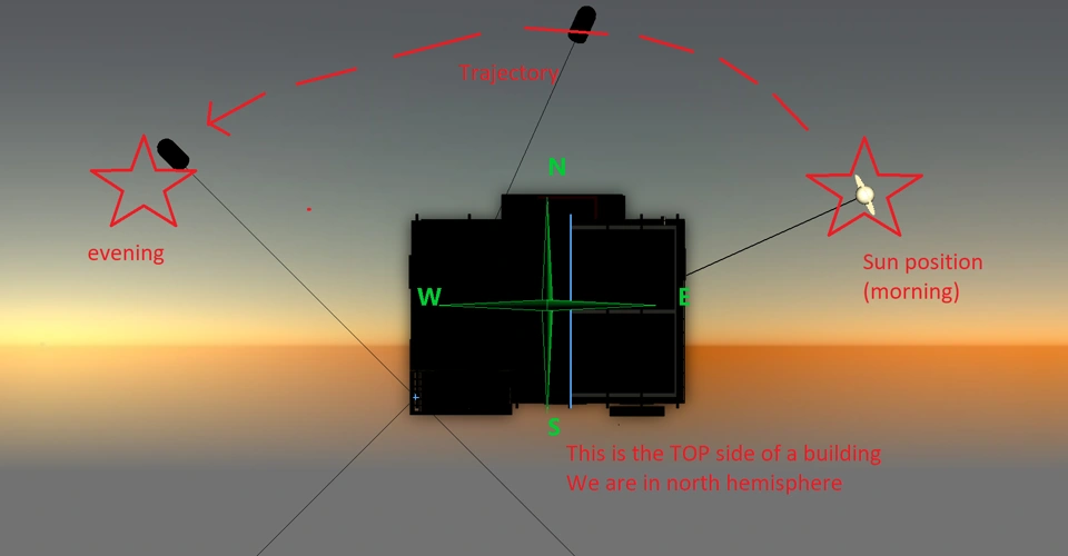

Hello,
Using sldwrks since 20 years, I just discovered that the sun itself can be simulated.
But following the help, it did absolutely not simulate things correctly.
I did configure compass and location correctly.
The sun wake up at EST, ok, but then, go to the north instead of the south.

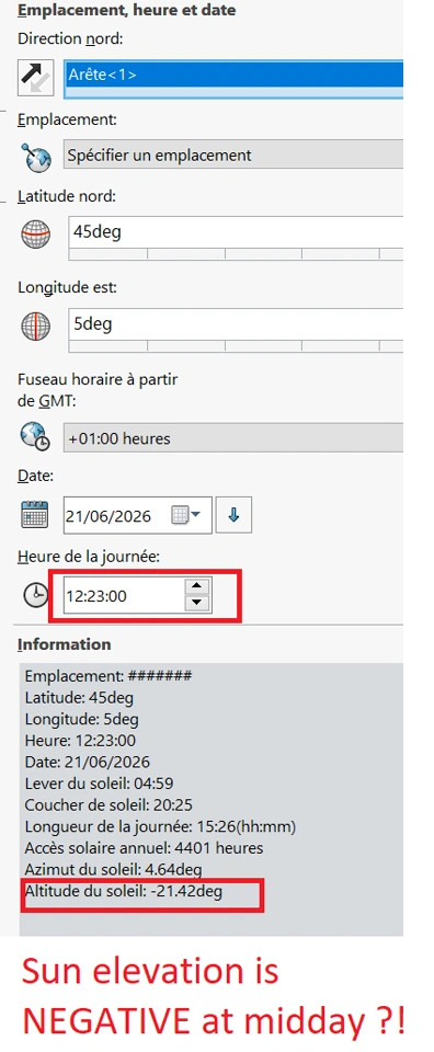

Also, on the configuration tab, there is a info field with computed solar elevation/azimuth. During the day, sun elevation is negative. Quite strange.
