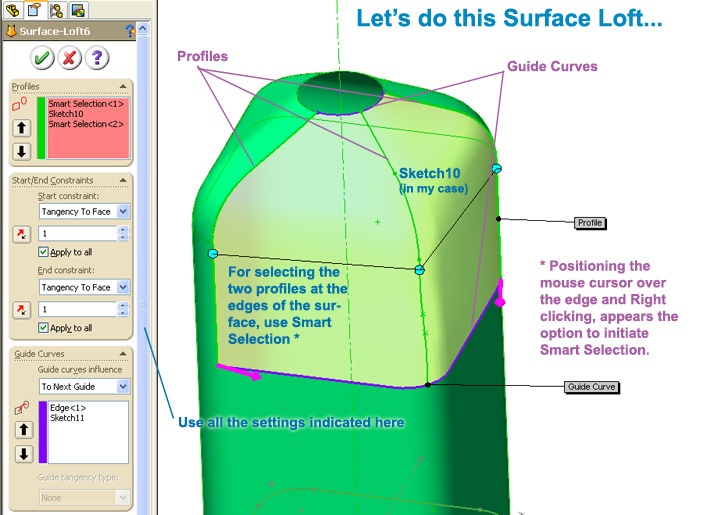

I've been trying out a tutorial from Productfourm.com for modeling a handle on a bottle and when creasting one of the lofts it said to use the smart selection for selecting the edge (note there is two edges to be selected). Is this only an option on ealier versions such as 2006 and if so what was the function. Before anyone says so there was a post on this but its an old one and you can't see the actuall question post or answer post.
