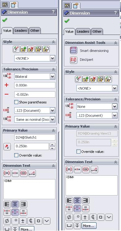

Hello,
I have a rather minor question. I have tolerances attached to the dimensions on the sketch and I am making a drawing of the part. When I use Annotation>Model Items I can import all the dimensions and the tolerances are there too. However, when I try to add a dimension using Smart Dimension on the same feature but in a different view, I can't get the tolerances to show up. They can be added manually, but that seems to be bad practice. So I'm just wondering whether there's either a way to drag the dimension from one view to the other or to add the dimension with its proper tolerances. What's strange is that any dimension I add manually seems to lose the link. The auto-generated once have a reference to the original value and can be changed (with the model updating), but the manually inserted ones do not behave like that.
Thanks for your help.
