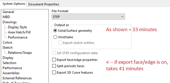

I've been using SW for 22 years. Lately, I have had to translate some medium smallish sized assy's into STEP files. This smallish sized assy took 33/41 minutes to translate.
If I translate to ParaSolid X_T, it takes about 11 seconds. I understand that the SW platform is built on the parasolid kernel, which makes for a much better, faster, more accurate translation.
So my question is, have you experienced very long wait times for STEP 214 file translation?

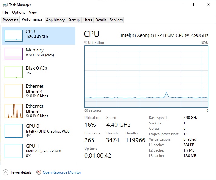

Here is a screen shot of the Task Manager while its converting:
