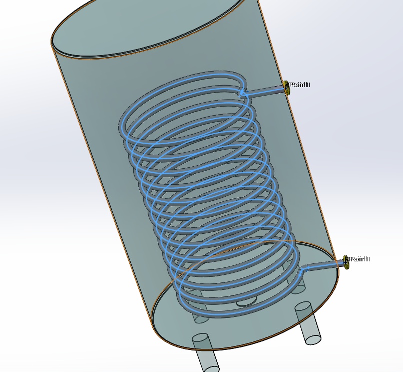

Hi,
I am using SW2013 (although i had the same issue with SW2011 as well)
My test bench, to describe the problem, consists of a cilinder and a sweep extrude, in his case a helix as can be seen below.
For some reason when i select the helix, or hoover over it, it takes a very long time for the display to show it as selected.
Instead of showing is all selected at once i can see the selection creeping up the helix until it is fully selected.
Also, if i keep the mouse over the helix it keeps selecting it and reselecting it.
What can i do to check the problem?
I changed what i could with the performanc optiones but it did not help.
an it be something with windows itself?
Intel Core i5-3450 3.2GHz
8GB RAM
win7 64
I have asus MB and i am using the graphic of the i5 core processor.
Though I do not have a high end system, for the small part i described above i should have no issues, or should I?
Can the graphic card be the problem? even for such a simple assembly?
