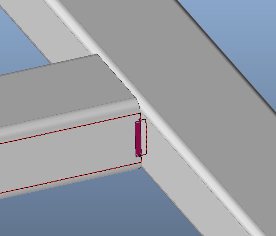

Thanks, We used to work with Topsolid 6 where i made this tool but we recently switched to Solidworks.
The dark blue part is the tab which gets merged with the tube, the light red is the  hole that get cut out of the other tube, the dark red are the laser notches on the sides of the tab so there wont be any excess material making it fit perfectly in the slot.
When inserting the tool you were asked for length, width and depth of the tab whereafter you could mate it with the side of the tube. It would then automaticly merge the tab, cut out the laser notches and cut out the slot.
I will try creating something similar as a library feature in Solidworks.
