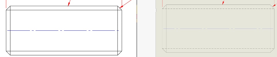

1. 15830-03.slddrw
- The hidden line is shown as  a solid line.
Image 1 shows eDrawings on the left and SolidWorks on the right.. The dotted line is a hidden line representing the inside diameter of the cylinder.
