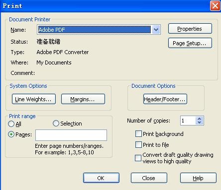

SldDrw File Converter to Adobe PDF is Error?
Follow Programe Code is PrintFileName is empty
   SwModel.Extension.PrintOut2 vPageArray, 1, True, SwDraw.Printer, ""
result is

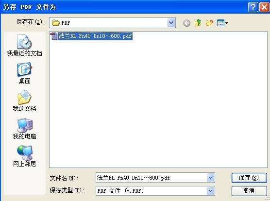

Manually select the output file PDF file,see picture
if Programe code is PrintFileNmae not Empty
   SwModel.Extension.PrintOut2 vPageArray, 1, True, SwDraw.Printer, PrintFileName
Programe  Error  is
When you create the postscript file, you have to send the main font. Please go to the printer properties "AdobepDF settings" page and deselect the "don't send fonts to Distiller" option
My target is Auto Print Adodb Pdf file.
Thanks .
