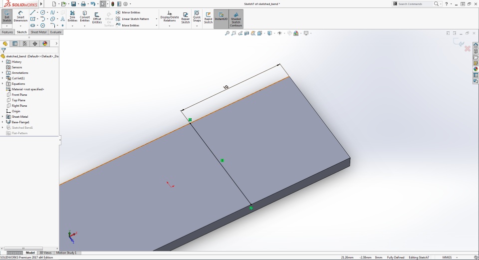

Hi,

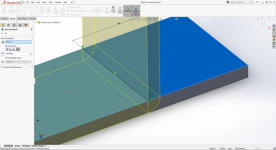

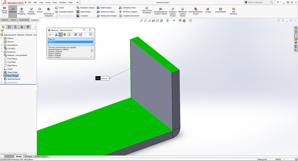

Could someone explain how to make a sketched bend so the dimension on the third picture would be 10mm. I would assume that since the line is 10mm away from the edge, the flange would be 10mm, but it is 9.06mm. I would like to do the flange with sketched bend and not edge flange.
