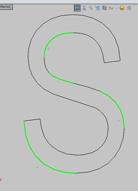

I'll spare you the details of why this is an issue (unless some of you are really curious), but some of that text doesn't come in as cleanly as I'd like.  Specifically... look at the letter 'S' in that shot, when I start grabbing edges from the split line command:

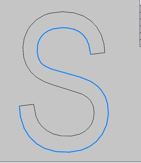

Obviously, creating the letter S in this font involves a mix of arcs and splines, that's not a big deal.  But the fact that the arcs and lines are separate edges is what causes me some troubles.  The printer that I'm (eventually) sending this to would prefer for this to be two splines and two edges instead of the 18 splines, arcs and edges that you see here.  Basically, if I selected an edge for the S, I'd want the entire thing to be selected, like this:
This sort of thing CAN be done... you have a RMB select the sketch text and choose "Dissolve Sketch Text", then perform Tools > Spline Tools > Fit Spline as needed.  My only issue with that is that it takes time.  For each letter S in that font, I have to select the 8 segments individually, since my only multi-select option (select chain) gets the entire letter. I'm hoping for a more streamlined method, but I have pretty low hopes here.
