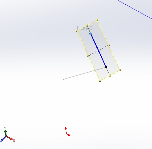

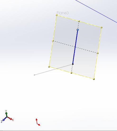

- Double click the new plane and draw a line from the endpoint of the previous line and add a "Vertical" constraint to the new line.
- Drag the free endpoint of the new line, you will see the new plane can rotate along with it.
