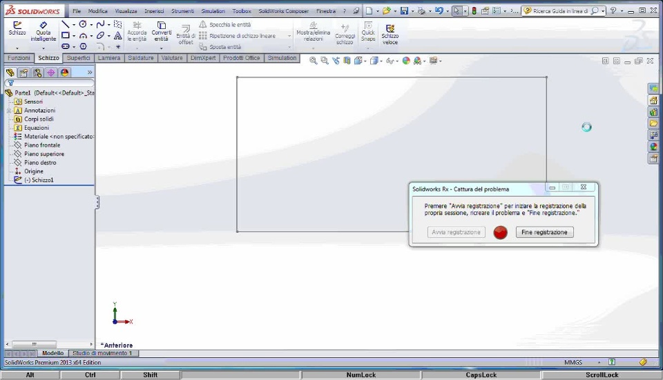

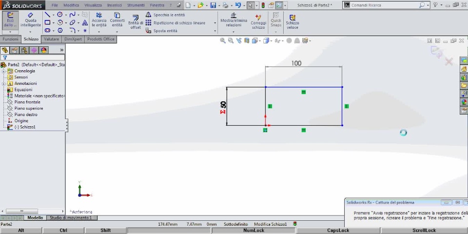

I was wondering what new feature is introduced in sketch equations. I've read the what's new manual but I can't figure out what's the new feature you didn't have in the past.
In 2013 I can create an equation in a sketch between two entities: say for instance I'm creating a rectangle, putting a 100 mm dimension on a side (D1), and then an equation for the dimension of the other side (something like D2@Sketch1 = D1@Sketch1 * 2.
