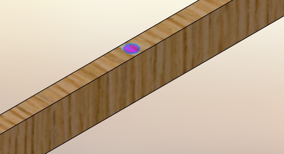

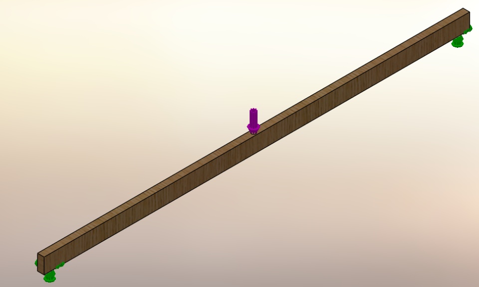

I thought I'd do a little practice exercise using the simulation module on some wood just for kicks.  I am not a structural engineer so do not know the math formulas for the handwritten workup, but thought it would be cool to see how much weight I could apply to the center of a standard 2x4 oriented the strong way before it breaks.  I took an 8' length and have each end fixed 2" inch from end on center.  I used the split line command to apply the force points as someone suggested on here years ago from an older post (see snips below).  I'm not sure though what the modulus of elasticity is for standard wood from hardware store.  Is it oak?  Nothing is in the material database for SW apparently.  I pulled up the matweb database (MatWeb - The Online Materials Information Resource​) and am not sure what should be chosen for this value in order to update the SW materials database as far as the modulus.  Any help would be appreciated for this value, as well as my approach.  I think I have it all set up properly, just when going to run the simulation there is no elastic modulus value on file within the software.  Thanks in advance.

Generally 2x4s are made of pine.  I think it is Ponderosa Pine, but don't quote me on that.  Also remember the fiber direction makes a huge difference in the property (wood is anisotropic, steel is isotropic).  So, make sure you choose the correct modulus.
A quick web search turned up this resource:
http://www.conradlumberco.com/pdfs/ch4-Mechanical-Properties-of-Wood.pdf
I haven't looked through it completely and verified that resource.  But, it looks pretty legit to me.

<p><span style="color: #333333; font-size: 14px; font-family: Verdana, 'Verdana Ref', Geneva, Tahoma, sans-serif;">...the math formulas for the handwritten workup</span></p><p><span style="font-family: inherit;">... thought it would be cool to see how much weight I could apply to the center of a standard 2x4 oriented the strong way before it <strong>breaks</strong>.</span></p>
What are the limitations of a linear static stress analysis?
1. The math is appropriate within the linear portion of the stress/strain curve.  (Break (fracture) might occur well past the linear portion of the curve.)
2. Istropic material properties.  (Wood is not isotropic.)
3. Relatively small displacements.  (Relative is, well, relative.)
4. More reliable if the aspect ratio between width, depth and height is not too great (another relative term).  (Take a veneer strip of that material and you can bend into a loop.  Now you do not have an aspect ratio that extreme, but you have a pretty long, skinny part.)
Use caution with your analysis.

<p>Dave Krum wrote:</p><p><span style="font-family: inherit;">... (but maybe not that simple since the wood isn't isotropic as you guys mentioned). </span></p>
Doesn't matter if it was isotropic.
SolidWorks linear static analysis does not calculate fracture.  So even if it was steel, you are not going to calculate (with that analysis) when it breaks.
